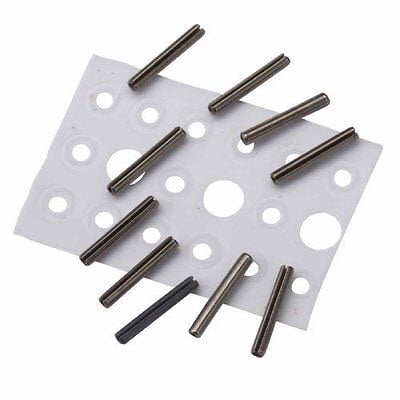

Have continued working on my old Victa Monaro.
Problem is the tanks warped so runs very rich.
Easy solution is #391413 roll pin and washer kit - problem is the kit is no longer available. One shop offered to sell me 10 kits for $90 but I don't really like that much - I only need a few for this and other ones
I would convert to pulsaprime, but I want to keep the monaro plate - which would block the primer
I've got roll pins which will fit, but I have never seen the washer. How thin is it?
What alternatives are there?
Thanks

The 391413 has been superseded to 4184 kit of 10 ea.
[img]https://i5.walmartimages.com/asr/f2...h=450&odnHeight=450&odnBg=ffffff[/img]
Boy what a markup, here they are 8.75 usd for the kit.

Amazon AU will sell you the 10-pack a good deal cheaper than that quote;
https://www.amazon.com.au/Briggs-Stratton-4184-10-Pack-Overhaul/dp/B0038U3M4A
I'd be surprised if Bruce at the ODK Shop couldn't supply a single kit, though - worth an e-mail, I'd say.

Gadge, I am quite sure it is cast alloy - it is the older square carby, not the later autochoke one with effectively the same shape as the pulsaprime.
I think I will just get that off amazon - only thing that worries me is the review at the bottom. That way I will have a few in the kit for future when they get really scarce.

I went to order the kit a few weeks ago, and thought stuff it, I can make a washer surely (don't call me shirley haha)
Unscrewed it, cleaned all surfaces, and cut a thickish old (but pliable) rubber fuel pump diaphragm from a line trimmer - no good. The choke wouldn't come off after starting, and the spring hole filled with fuel. Then I removed that and put a thinner cut piece of metering diaphragm - much better but choke wouldn't close fully or close slightly when revved up. Put it away for 6 weeks and ripped the carby off yesterday.
I thought maybe a thin piece of the line trimmer fuel pump diaphragm made of teflon (a blue coloured one). smeared a bit of grease on it to hold in position and put the carby back on.
10 pulls and only one cough. Was about to go back to the drawing board when I remembered the needle valve was shut to 1/4 turn (only way it would run before). Unscrewed to 1.5 turns and it fired up 2nd pull, ran 5 minutes then tuned and set idle. No black smoke, even when revved hard from idle straight up to 3200 rpm. Choke shuts as it should including slightly when revved. Started first go 2 hrs later
