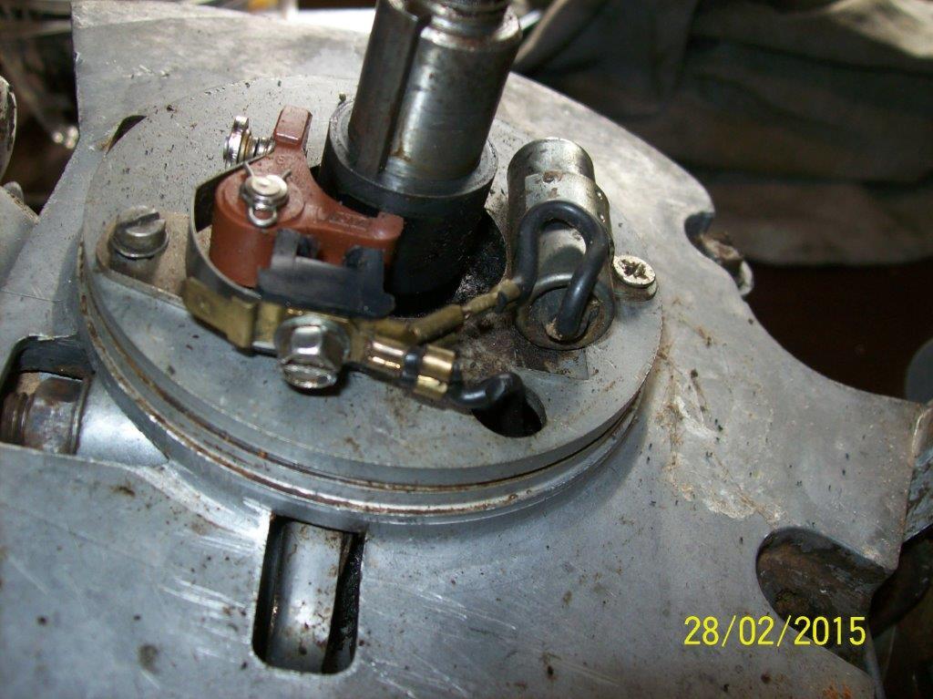

Here's what the points look like.This engine is the first of the Twin engines and isn't one of the updated versions.So it didn't have the dust cap to cover the points.The updated engines did.That's why you can't see the rubber o-ring on the ignition plate.
Hope they are of some help to you.
