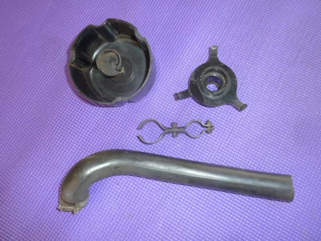

At some point, I'll need to look at the starter as it's not always recoiling. This one has the metal wire rope, something I have never seen let alone dealt with before.
As intended, I bring it out for the occasional mow, its just so charming.
Those starters can be a pain to get working nicely. When you look at repairing your starter and if your bothered you can buy new reproduction rubber handle covers in either black or green for $50 from a bloke in Sydney.

Here's the photos I couldn't PM them.
