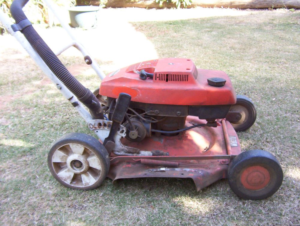

hi here is a pic of a a utility i was given one time it hadn,t been run on mix and siezed the engine i found an engine at the tip,and set it up on the old frame. the rear wheels came off an old rover,i had a throttle and air filter in the shed so fitted it up.it started up after a few pulls and only ever had one problem, it run out of spark,the point gap was nill,i gave them a bit of gap and away she went.its a pretty rough old turn out but reliable and when its full noise sending heaps of grass out its a real buz to use cheers micka

they are agreat unit, I find some have a problem with a flogged out height adjustment but apart from that they do a pretty good job. My main one just gets used for scrub, but the old 160's power through it.
